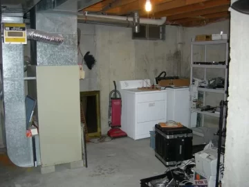

In the attached photo you can see the stove flu with a towel stuffed in and the furnace to the left. Everything else is just storage (i.e. - no other fireplace or washer/dryer hookup). You can see the wall coming out to the right. This alcove is off to the right of the rest of the large area of the basement at the far end of the basement pretty far from the basement steps.
Our goal for this stove is to be emergency back up heat in the event of a prolonged power outage but it would be great if we could also use it as supplemental heat in the coldest months in addition to our pellet insert in the main living area.

That helps a lot. What an odd place for a fireplace. This looks like a really tight fit with the washer so close. What's the distance between the furnace front and the dryer? Looks like only about 5 feet. Are you thinking of relocating the dryer?
There is no fireplace there, it's just stuff being stored from our previous fireplace before we put the insert in on the main floor. The washer and dryer are only being stored there. The washer/dryer and everything else except the furnace can be moved.

Sorry to pester you for another picture, but I want to see the clearances on the wall side of the furnace. It's hard to see all options from the one shot. Can you take a picture standing back from the return of the furnace, looking into the alcove? I am wondering if there is clearance for a flue from the stove to reach there?

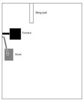

Here is a sketch of what I was thinking. Not sure if it's possible.

Don't put it in your basement. Your walls are not insulated - you'll lose massive amounts of heat to them. Do a search here for "basement installation". As you'll likely have to reline the flue anyway, why not just break into it somewhere else upwards?
Thanks so much for all your suggestions. Here is the layout of the basement. On our ground floor we have a pellet stove insert in our fireplace which is in our central room with cathedral ceiling so there's no where to tap into the chimney. We are thinking of insulating the basement but still aren't sure if it's worth putting the stove down there. We have so many windows that it's hard to find any wall space. When we are able to redo our kitchen, we could create a space in the kitchen, but that will be a ways away.

Remember this, the wood stove does NOT have to be directly in front of the wall thimble. You can move the washer/dryer, install the stove a safe distance from the propane furnace, and run the stove pipe up then laterally along the basement wall, then make the turn into the thimble....
all provided you research the proper clearances with the proper authorities.
