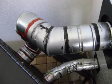

My Harman manual directly states:
Note: Do not place joints within wall pass-through
I used two 90s off the stove, then a 45, and finally a 6" and 12" straight. This puts the 12" (last) pipe joint about 2" outside. I have 6" walls so a typical 2x4 wall would have given me 4" outside.
  • [Hearth.com] Question for installers
