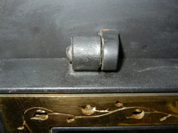

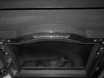

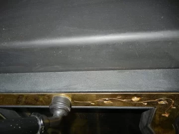

Someone didn't do a very good job of putting in the gasket. There is no adjustments on the hinge side and the latch can be adjusted. Should be a pretty even gap in the metal around the door.

Okay, I can definitely see this now. I'm noticing that the gasket sits flush on the handle side and sticks out on the hinged side. Is this because the door hand is too tight? It's the newer model P68. Where can I find new gasket? What size is it?

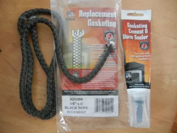

3/8 inch rope gasketing. Can get as a kit with adhesive. I highly recommend using-getting the gasket material that is graphite impregnated. Did three stoves last week. Pretty easy project. Hardest part is the cleaning of the channel that the gasket sit in. Wire wheel for a drill and only a few dollars and can help with other stove cleaning projects latter. Probably could walk out the dog a bit on the latch after new gasket is installed. Think I am referring to the latch part right?

Also, where can I purchase the rope and that adhesive you mentioned?
I have a big store chain here called Menards that is a home improvement chain. Yea also a son that goes in circles in NASCAR. Picture should give you enough info to search online. Think the kit was under $8. If the dealer is not to far away I would have them adjust it. I have not had to adjust on yet. Maybe someone else can chime in or start new thread about adjusting the door. Lots of Harman owners on site.
