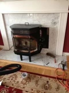

[Hearth.com] Question....As you can see I have a pellet insert (PI40) I do not have an OAK and no plans this year but I did notice inside the Fireplace is an outside air vent that looks like a dryer vent. Should I leave this open or closed to allow the stove to draw air in from that? Or does it not matter at all.Thoughts please?

Not required if not in a manufactured home or required by local code. If left open it will pull some air from that vent. I would use the vent for my OAK as long as it conforms to the specs outlined above. IMO

if you do not have some type of conduit running from the stove to the opening then block up the intake of your fireplace to prevent drafts and whatnot fromt he outside coming into the home.
