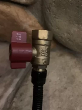

So, should I use a male/male 1/2" to 3/8" coupler to connect the existing standing gas line to the stock line attached to the new stove?
If the threads match at each end & seal tightly, go for it. Pictures of what you have for gas line will help…
Silver line is existing supply - the black line/ with the shut off coupler is attached to new stove. It looks like the female end of the coupler and the female end of the existing supply line are both about 3/4".
[Hearth.com] Questions about replacing old natural gas Traditions Earth Stove with new Vermont Castings Radiance [Hearth.com] Questions about replacing old natural gas Traditions Earth Stove with new Vermont Castings Radiance [Hearth.com] Questions about replacing old natural gas Traditions Earth Stove with new Vermont Castings Radiance
Both connectors have pipe threads, but it’s a little difficult to see exactly what size they are from the side. Can you post a pic looking straight into the ends, side by side?
You may be able to make the connection between them with a short nipple of 1/2” pipe.
This is the fitting that you need. The straight end is threaded into the red handle shut off valve and the flare end is connected to the silver appliance connector.
