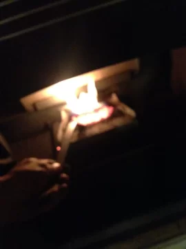

It is just like that old game called Operation, touch the sides of the stove and you may get burned!
Click pic to enlarge>
