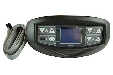

After quite a few years of repairs and modifications, our mighty little heater appears to have hit a possibly insurmountable obstacle. The control panel power button has quickly decided it does not want to function. It suddenly takes multiple depressions and cajoling to either turn the unit on or off. Each time it becomes more difficult. This is an old machine even when I purchased it new. I’ve found it to be an early RDS unit with the old style control panel. I believe it’s 2007 mfg. No luck finding a replacement control panel. A remote control would solve the issue but this unit did not come with a remote and I don’t believe these older flat panels support remote. If anyone knows of a parts supplier, new or used, whom might have access to on of these controls, or a shop that repairs at this level, info would be greatly appreciated. It would be a waste to have to retire this unit after all the effort to get it running so well. Thanks, Jim

Your stove not listed but you can call and ask. Looks to me to be a standard momentary switch

I was wondering if this is a tactile switch, is there anything that could be cleaned to get it working again?

Thanks for the link. It’s difficult around here to find a repair source for electronics and board level repairs. I do all my own appliance and electrical repairs but small component and soldering are a thing of the past for me. It’s definitely a tactile button as wideknuckles terms it.
Display for Ecoteck / Ravelli with 6 keys - This is what they call it - not sure if your manual would have the part number.

There way be an upgrade for your stove. That might involve the next generation control card and display. Give this site a good search and goggle too. It seems they may have upgraded to a display with rounded corners. If you had an electronics person look at the display, and where that start/power button is on the ribbon cable ect, then it should be possible to add a pushbutton in parallel and mount it on the back of the stove or even on the display board. Finding another new card would be the easiest fix, or sending it away for repair as ARC said.
You could try moving the display card and seeing how/if it comes apart. Maybe the membrane comes off leaving the board exposed.

Thanks for the suggestions. I am going to keep the stove in service as long as I can for this heating season. Once it completely stops responding I will begin disassembly. In the meantime I will continue to gather info and devise a plan or two. Thankfully we also have a Jotul 3cb without buttons, boards or cords 🙂.
