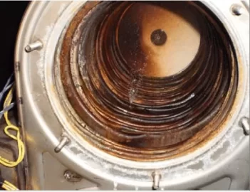

Here is a 4" HW main from a building in Minnesota. Hard water continue to precipitate out, and the higher the water temperature, the more the minerals come out. You spend a lot of $$ on these hydronic boilers and components, good quality fill water is a cheap investment to assure the best HX performance.
Also a shot of a HX from a small condensing boiler that had started to lime up, and caused the stainless HX tubed to over heat.
