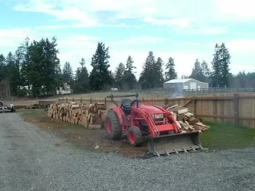

There were a few companies that made a splitter that attached to your tractor's PTO shaft. It works like a big screw with a taper much like a traffic cone. As the unicorn horn screws into the side of a round, the round is split open. It works fast, efficiently, quietly, but not safely. Many folks have been killed or lost limbs with these devices. The makers of the tractor mounted splitters have gone away due to the lawsuits.
They are dang darn fun. Just don't bend over and let this thing screw into your ear or your rear end or catch your sleeve or... Cause there ain't no way to stop it from spinning and it has the power to rip your arm clean off.
I split up no less 2.5 cords today before the rain came. I had a log load delivered that was supposed to be 4-5 cords of doug fir.

Nice tractor there Highbeam.....is it a Kioti?

Yes it is a Kioti brand tractor. It has been a fantastic tractor and I am thrilled to find another use for it, I have put 620 hours on the clock since new. The fuel gauge has not moved from full yet since I started this splitting mission some 10 hours ago. Off road diesel is cheap and the tractor running this way is easy on fuel.

I got the wood all split up. It took about 14 hours total of splitting and sucked up about 4 gallons of diesel. Plenty of breaks to rest. I hit one huge ants nest that totally dumped out milions of carpenter ants. Gross. I brought out the chickens which sat there and ate a million ants. Our eggs our going to taste fANTastic.
Those fence posts are 10 or 12 feet apart.
No injuries at all. Now for the stacking.
