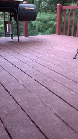

I have used the Restore product on my deck. Its going on 3 years and still looks good. It is a durable product.
I brushed it on but would suggest you use the enclosed roller as it has a sand in it and you need to mix it good and keep the sand even in the mixture. Rolling it I think does a better job of getting an even coat of the sand in the product. Brushing will cause the sand to be pulled one way or the other but I got around that by gobbing it on and barely brushing it. You put on at least three coats I think but it gives you a very durable coating. Best coating I have ever used on a deck as all others seem to only last a short time. The multiple coats makes the textured look , look more even so dont get scared after the 1st coat , by the 3rd coat the sand looks more evenly spread out. Even with the roller put it on as heavy as you can and roll it as little as possible.
I would use it again and would recommend it.
I imagine people who reported problems tried to put it on like it was stain, they most likely put it on thin and spread it out to save on how many gallons they used.
When mine was done it looked like a redwood flat finished bed liner coating with a slight grit texture for traction.
Since the thicker you put it on the better and its a thick product anyways plus you need 3 coats, its good for restoring really bad shaped decks as it fills in all the imperfections of a really weathered old deck.
I power washed my deck to get good adhesion.
Ok I added a pic when I got home this is the deck after 3 years and I live in a wooded area we all know what that does to a deck.

Thanks Huntingdog! What was the original coating on the deck?
Over the years used several things, 2 different times used waterproofing with redwood color in it, then a couple different stains both solid redwood color. The last attempt I used Benjamin Moore primer and Benjamin Moore solid stain. I cleaned and power washed on all attempts to find something that would last. The story I got from the Benjamin Moore people is that the moisture comes up from the bottom thru the boards and causes issues.
