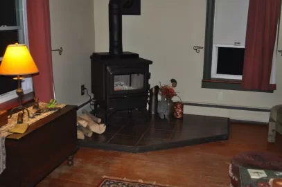

Ok, so I built my hearth, installed my stove and did one real burn. Paint smell is finally gone. My question is this. Seems that I can't get a fire going without leaving the door cracked for a while. then once I have a bed of coals I can't get a good burn (door closed) unless I have the flue wide open. Shouldn't I be able to burn decent with the flue half way or so? I am about as new to this as you can get but couldn't really find what I needed using the search feature.

Whats the pipe config? Is that a 90 I see in the pic.
yeah I'm betting the chimney's not tall enough to draft well especially considering the 90 degree and horizontal run, and if the house isn't well sealed (especially in the ceiling and attic) that will aggravate the problem further. See about extending that chimney at least a few feet.
The config is 2 90's. One elbow that you see in the picture going outside then a elbow going straight up. I think the guy installed three sections. I would think I would have to convince the installation guy that there is a problem to warrant him coming back out and adding a section. He seemed to think I had well over what I would need in height before he left. The house is a cape cod. The second floor has to converted bedrooms with 3-4 foot knee walls.

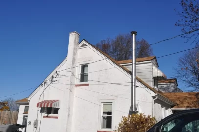

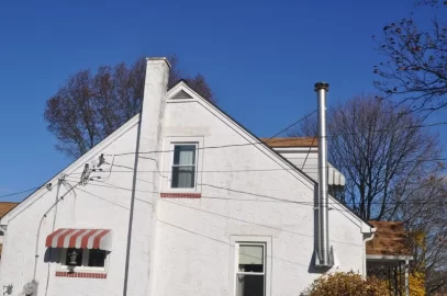

Here is the chimney from the outside. It looks to be a couple feet lower than the peak. Maybe one more section would help but we have some serious wicked winds hear.

I believe the minimum height measurement your chimney is suppose to be is 2 ft above the height of the roof 10 ft away from the chimney.
[Hearth.com] Regency 2400 flue question (new Pictures Added)
Looks like you have close to that, but not "well over what you need" as the installer told you.
Frankly it looks tall enough for normal usage, but sometimes in the wind you can get problems with the wind turbulence created off the roof, that's why they want you to be a certain height away and above it to minimize that effect. But your flue looks plenty high enough, for calm conditions.
