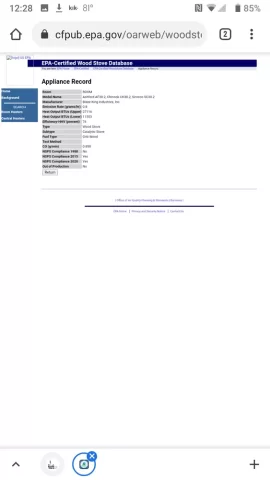

.9 gms/hr is not twice .8gms/hr

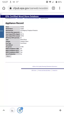

You're right, I was looking at princess with the 0.4 gph.
I should also amend my thoughts above to say that the chinook output range is 11.5-27k btus.
Oddly, the F3500 is listed as a cat stove and NOT a hybrid. It actually has pretty good specs.

You're right, I was looking at princess.
Blaze king lists the Chinook 30.2 at . 8 gms/hr. Not . 4

Here are the EPA numbers to compare
