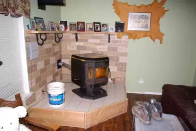

Last winter I did a little bit of Home Improvement here and built a raised hearth and installed a free standing pellet stove.
You can build a corner hearth and do some fancy paint work and other little things that make it look like a bricked in hearth.
Having the ability to access the stove in a hurry without wrestling it out of a hole, especially in the dead of winter can be a nice thing.

Here is a piccy of what we did in the family room.
The pipe in the upper part of the pix is left from an old pellet stove that we had in the corner back when we built the place.
It was a full rise chimney that went out and then up to above the roof line.
It was a royal pain to clean.
The current setup has about a 4 foot run from the stove, out the wall to the terminus.
Easy to suck out with the shop vac and then the leaf blower to finish it off.
Dont need any ladders or any of that stuff.
