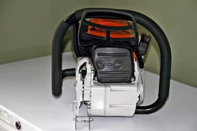

Anyone have any advice? I can only locate two nuts on the front of the muffler. I'd prefer not to destroy anything in the removal, or take it a shop. It is really on there.
Should be 4 but never work on a 441. t27 torx with t-handle is the best way to go.
I agree with Smokin. But I never looked at the 441. Was gonna buy one, but settled on the 460.
There is 4 on the 460 (and my 036) 2 short ones and 2 long ones. Then tap lightly around the outside. There is a gasket they may be holding it on there...
And then 2 more inside to remove entire muffler assembly.
Can you post a pic? May help. . . Or hopefully someone with a 441 can verify...
Take off the two nuts, slide the bottom out a little, & top should slip out from under the lip. Take the bolts out of the inside to remove the body from the jug. A C
Thanks, A C. Where can I safely apply some pressure to get the bottom to loosen up? When you say "top", would that be the same as the front of the muffler? This thing has a dent in the top which might be why it isn't coming loose easily.
Thanks Dave, my bad, I was working on the wrong saw in my head. A C
Must be way different. I looked long and hard at the 441.
You can see the torx heads on top and bottom. This was after the dual port muffler was added.
Hope you get ot off of there. My gasket had the outside cover stuck. I removed the outside cover and internal body to put the dual port muffler on it. [Hearth.com] Remove muffler on MS441
Hope you get ot off of there. My gasket had the outside cover stuck. I removed the outside cover and internal body to put the dual port muffler on it. View attachment 68415
That's not a 441...... That's your 460!
Here's a 441...
Photo originally from:
http://photo.blsnelling.com/Chainsaws/Stihl-MS441/14767852_3bQMZL#!i=1223942712&k=44L8z
I finally got a service manual from someone on arboristsite and got the muffler off. Stupid metal plugs that I thought were holding something internal to the muffler. But simple enough from there. Thanks for the input, everyone.
