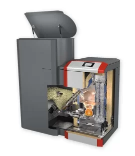

Maybe a possible route is to install a 10'x10' shed where the OWB is located and install the new pellet boiler in the shed. This way you can keep using the underground piping to the house and other heating infrastructure
Windhager has a pellet boiler model BioWIN2 with a 450 Lbs pellet hopper. This is then a bagged option.
Windhager also has the full automatic option with bulk pellet delivered pellets.
Not many installers in NY. Most our customers do self install.
