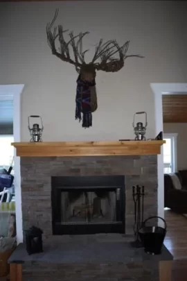

You talking abut mine? :) shameless chance to post pics of my alcove again.
(broken image removed)

cwill, you can post that beauty at every available opportunity. Like a fine wine, it just gets better. :) Rick
Cwill - That's pretty close to what I have.

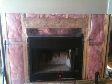

Having done a total ZC demo I'm with the other posters here and say go for it. It will take some work but it's well worth it in the end. If you're relatively handy you can do all the demo yourself as well as some of the finishing to save some money. I did the demo and prep work, had a sweep install the pipe and fireplace (DW - still wanted the ambiance of a fireplace vs stove) and then did the refinishing. If you're fireplace is giving you signs that something just isn't right then why take a chance ? As part of our demo we found all kinds of code violations that were just trouble in waiting.

I replaced my prefab. One of the best things I've done for my home since I replaced my windows. Not cheap, since the existing pipe wasn't usable, but worth it in the long run if you ask me.
