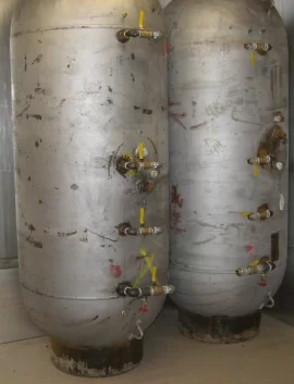

Do you have a source for used propane tanks?

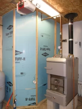

In my neck of the woods I have a very good source and am able to get "stubby" 500 gallon propane tanks. After a base ring is welded to these tanks they stand at 8'10". These work very well in rooms with 9-10' tall ceilings. I you can easily join 2 of these tanks together and then enclose them in 1-1/2' tuff R foil faced foam - works great!
See the photos attached to this email [Hearth.com] Researching systems[Hearth.com] Researching systems
Brian what is the diameter of the stubbly tank?
What is the length before the ring is added?
gg
We leave approx. 2" gap between the bottom of the tank and the floor so as to put insulation between the tank and floor.
Thus, this would mean an overall length of 8'8" before adding the base ring. The diameter of these tanks is 41".
A normal 500 gallon tank is 10' long x 37" dia.
