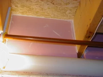

I'm still at it. I'm about a third done on the third wall which is one with a lot of bays.
I'm doing about one bay a night, but on this wall I'm doing five layers, covering the top of the concrete and meeting the wall foam.
I think I'm getting it pretty tight, caulking between each layer.
I've noticed a lot less condensation when it's warmer. Today's bay didn't have much.
But man, this is so tedious.
I have plenty of detail work to do on the wall foam too.
I probably should have made more use of the Great Stuff.
I'm going to foam those spaces below.
Another void is pretty deep so I might try that straw trick.

I started with the walls but then thought that I should do the rim joist area which is taking a long time.
