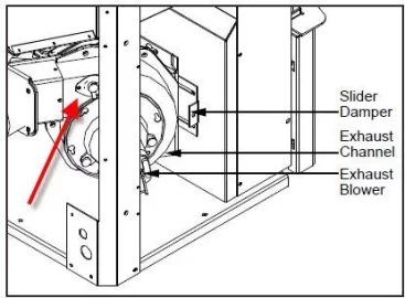

The room fan turns on when the snap disc mounted on the exhaust blower reaches approx 120 Deg F. See the red arrow in the pic below. If this disc is bad and stuck open the room blower will not turn on. If the room blower does not turn on the stove will overheat and trip the Hi Limit snap disc.
Also if the room blower has ceased up and not working then it will not turn on.

Hello
How do I know if the disc is bad?
Jump it out!

Ok, A continuity checker of Volt-Ohm meter will only show Zero ohms when your stove is cool when testing the snap disc.
Remove the wires from the snap disc and connect them together. Turn the stove on and if the room blower comes on in 5 or 10 minutes like it normally does then the snap disc is bad. :-)
