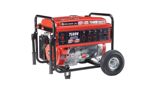

I run my Eco 45 with a 7500W generator.
The power went out for a couple of days this winter so I had to fire up my generator. I have a plug in my
garage I can plug my generator into and power my house, it powers lights, refrigerator, water pump, and all the
plug-ins in the room where the pellet stove is located. I run all that on a 7500W and my stove run fine.
