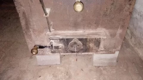

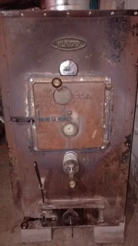

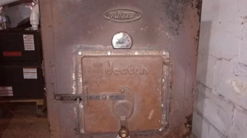

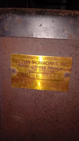

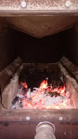

    Need help finding an owners manual pdf or online link.

    You probably wont find one. They may have never been one to start with. Why do you need it?

    I found one online "think this form originally" for a stove similar to this by same company called the "H2o" but its more or less just because id like to read it and learn as much as I can about this stove. I think it pretty neat to have acquired an old stove like this still in useable shape. Also it would list the clearances for the stove since it dont have a rating plate. HomeOwners INS thing.

    Without a ul tag it is an unlisted stove and the clearances are 36". This furnace is also a much better coal unit than wood

    After doing some online research I also came to that conclusion, due to the shape of fire box the shaker grates and how it drafts only through the ash door up through grates..

    They are sold as wood coal combos but it is an old coal furnace design
