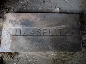

can buy it relatively cheap for fiddy dollah so don't you holler! but... can't seem to find the fire bricks in that size and many are toast. brick as photo shows but no idea if original. any specific thing to check?

Is it a standard sized brick (9" x 4.5" x 1.25")?
If not, what are the firebrick's dimensions?
any and all thoughts welcome. thanks folks!
Can't you cut fire brick if it's bigger brick you can get?
nuckles, probably can. oh boy! I get to buy another one use tool ~:-)

essentially needs 10 bricks and new rope but otherwise no apparent issues. everything seems functional and present. and this stove seems to be dual purpose coal/wood as it has a grate and shaker.
a bit peculiar design with the coal grate though. I'm wondering if that comes out when you burn wood and you just put more fire brick in the bottom?
begreen, yes appears to be standard bricks.
