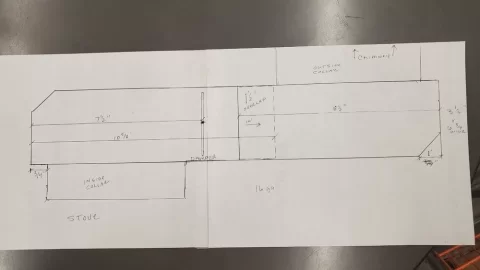

Thinking about moving the stove 10" further into the room. It will take a custom offset.
Does smoke care if it moves from round to rectangle and then back to round as long as volume is equal?
Pic is turned 90 deg.
[Hearth.com] Satisfying

They make adapters for your situation.

So no knee jerk disapproval was directed towards my offset pipe design ...I will take that as a thumbs up, Thanks fellas.
So no knee jerk hate was directed towards my offset pipe design ...I will take that as a thumbs up, Thanks fellas.
Offsets are not a great option. But at times they are the only one. But it won't make your setup any less dangerous
