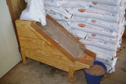

Try this method. It virtually eliminates fines.
[Hearth.com] Sawdust accumulation on the bottom of the hopper
