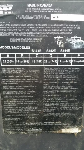

Do you have the model number for this Haugh stove? Can you post a shot of the UL label from the back of the stove here?
This is on back of stove.
