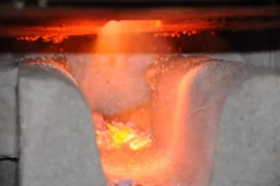

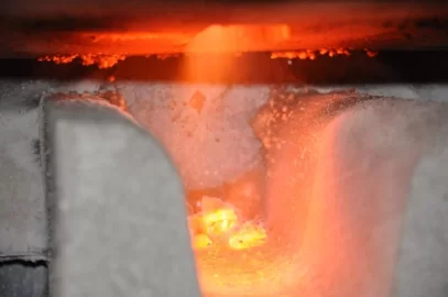

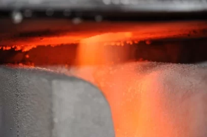

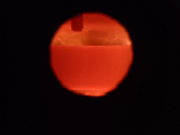

My camera on secondary wont show blue flame either? But I can play with the air controls I made and change flame from lots yellow to purpel to a white & orange to all most clear, which is the hottest you can get, cant even see flame but everything in there is bright red. My boiler is an updraft and home-made..
