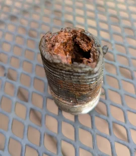

Finally fixed this. As expected, that nipple was badly corroded, in fact the corrosion by-products had created nearly a 50% constriction ...
... the deformation is from removing it; I was afraid it might be seized and I'd have to go buy a new pressure tank. Speaking of which, the pressure in the tank was 24-25 psi, and I don't think it's been touched since the house was built 37 years ago; so I pumped it up to 27-28, for my 30-50 psi pressure switch.
The piece is definitely magnetic (so I guess that means it was galvanized or black pipe ?). Some plumber being lazy in 1988, but hey, I guess 37 years isn't that bad. If I had more corrosive city water, might've been a different story ...

Yep definitely iron pipe of some kind. Somehow the outside color still doesn't look quite right to be galvanized, but that's exactly the way galvanized plumbing fails.
