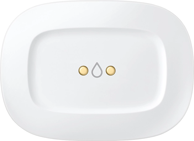

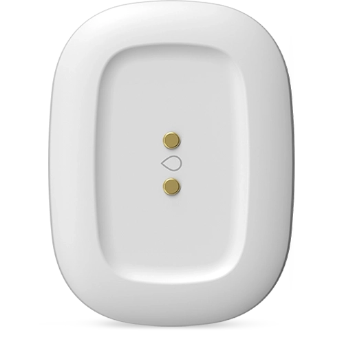

Not sure what your budget is for this project, they have IOT water sensors that could do what you want. I actually have about half a dozen in my house placed in various locations ( sinks mostly ). You could buy a water sensor and then setup an automation that turns the water off to the house when the sensor senses water.

I like to the IOT stuff because you can set it up to send you alerts, and you can check on it remotely. I've gotten alerts before when I've been out of town and I've sent a neighbor over to make sure that nothing catastrophic has occurred.

I am not familiar with the technology, but it is interesting. I assume that the sensors you use are all connected through wi-fi and not wired. Are you using a Zooz system with Aeotec water sensors?

My setup at home uses Samsung SmartThings along with Aeotec ZWave or ZigBee devices ( similar to a WiFi device ). In the U.S. I believe they spun it off to Aeotec. SmartThings uses ZWave or ZigBee devices that have to be certified or built by Samsung / Aeotec to work with their hub. There are other hub vendors other than Aeotec too. All ZWave devices feature end-end encryption so it's not possible for someone to possibly snoop on the traffic. The Chinese IOT Wi-Fi devices you buy from Amazon or some other sites are known to have backdoors built into them or are poorly secured by the vendor. One of many articles you can find by a Google search.
Once you have your devices setup you can setup automations. I had an automation setup that would turn the heater on for my cattle's water when the temperature got below 32F. When the temperature got above 32F it would shut it off. I currently have an automation to turn some lights on at 4, and shut them off at 11 every day of the week.
