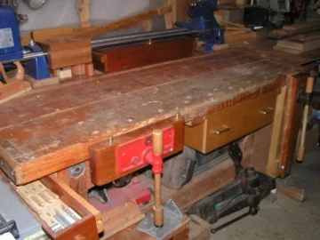

When I was wanting to upgrade from a smaller AMT lightweight 3 speed model with 48" bed,because of my limited shop space I chose the heaviest benchtop model lathe I could find.In Apr 96 I bought a Record Coronet No. 3 lathe 5 speed motor with solid cast iron headstock/tailstock & 1 1/2" x 48" solid steel bed bars.With the Outboard Turning Arm & Swiveling headstock I can turn bowls/platters up to 24" diameter on lowest speed.Not sure if Record still makes it or not,their main foundry/factory in Sheffield England closed a few yrs ago.The main design of the lathe hadnt changed since its intro in the late 1940's.The only plastic on the whole machine is 1 knob on the end of the Tailstock locking bar.Everything else is thick heavy enameled cast iron or heavy chrome plated steel.Heavy brass knob for headstock pulley cover (Which I drilled,tapped & installed small brass hinges after the Warranty expired :coolsmile: )
Total weight of lathe is 250 lbs,its used on my main bench which is built of 3 x 12 milled smooth & flat old growth Doug Fir with 3 x 6 legs,bench is bolted to concrete floor for no movement or vibration has lower storage shelf with other things on it.Guessing entire weight of lathe,bench & contents is easily 800+ pounds.Bench is 3ft deep,center of pulley is about 47" from floor.For my height its sometimes a bit much depending on workpiece,but I've adapted to it.When its used,lathe is slid to the front edge of bench.
Ignore the clutter,I need to reorganize & clear things off.Anyone knows that any flat surface in the shop quickly becomes a place to stack stuff.... ;-P
