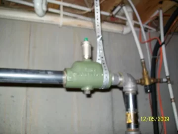

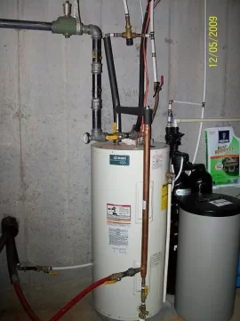

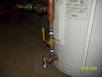

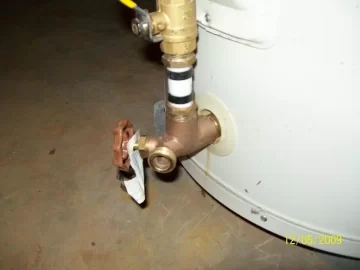

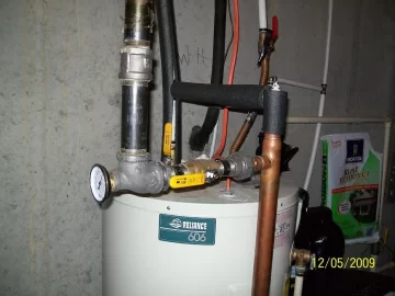

some pics of my sidearm. Purchased from Cozy Heat.
  • [Hearth.com] Side arm plumbing

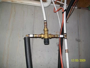

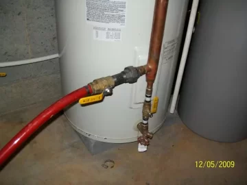

More pics. The bottom vlave was purchased from Lowes and allows for you to still have a drain for the hot water heater, if needed.
thanks for the pic's . I got mine fixed. leaddog was correct the plastic piece was removeable but it was pretty tight and i dident want to break anything over the weekend when i couldent get parts
