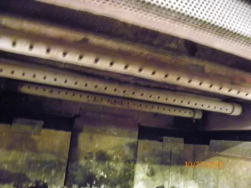

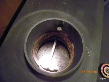

FBF, this is the inside of the Liberty non-cat. Since Jags brought a good point up on the Liberty it's called a by-pass, in the picture you can see the rod going across so when you pull the handle to the right it will open up.
zap
  • [Hearth.com] Silly EPA stove question
