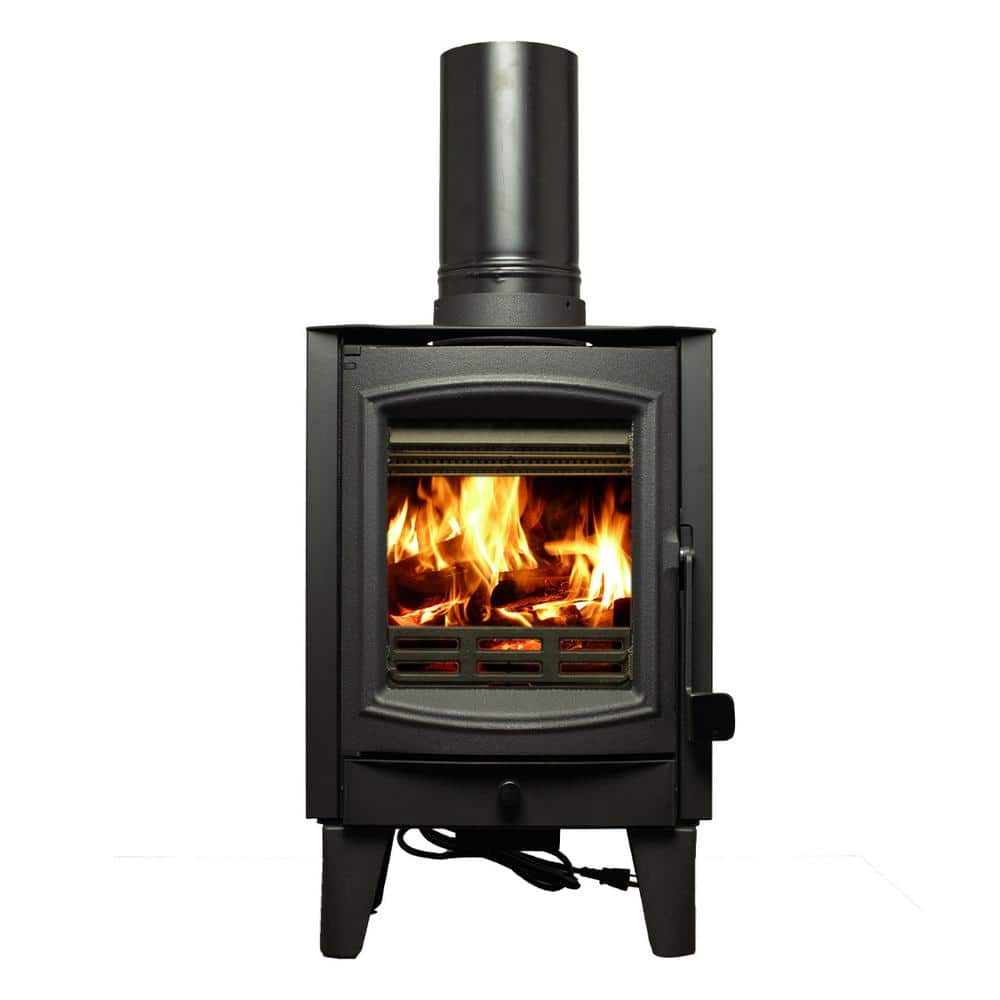

We have this wood stove:
That we are going to install in a small bunkhouse at a remote property. The bunk house is 10x20' and bare studs inside. The ceiling is also bare rafters and exposed plywood sheeting under the roof.
The stove will go in a corner and I understand how to build a fire proof platform and instal metal on the walls with air gap.
US Stove US Stove 750 sq. ft. Tiny Wood Stove, 75% EFF TH-100 - The Home Depot
Make your wood wall look new and attractive by applying this Unbranded US Stove ft Tiny Wood Stove.
www.homedepot.com
