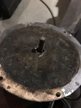

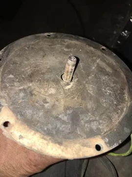

I would never be able to find the thread, but Mike from ESW explained a few years ago that a little smoke escapes around the shaft of the exhaust blower on pellet stoves on cold startups. I know it does on mine. The first year it drove me nuts trying to find the leak before he said that.
Hi BB
Here is a good pic under the fan blade of the hole around the shaft you are talking about. I just pulled the blade on this exhaust blower from an old Travis Pioneer Bay Insert. It is the standard Fasco 1.0 amp closed frame pellet stove blower.
Due to the centrifugal force and the wind current created by the blades very little smoke can escape.
