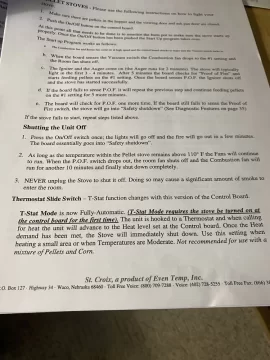

I was forced to replace the board/controller on my St Croix Prescott EXP and now I have a question or two.
I am new to the smart stat feature the new board has and not sure if I want to keep that engaged.
on my board I have 3 settings:
Manual, Tstat and smart stat. I believe T-Stat and Smart-Stat now do the same exact thing and only manual will let me control when there's fire and when there's not
My old board would not shut the stove down once it hit temp, it would drop down to an idle and still make heat. Now once temp is met it shuts down completely. I am not certain I want to work this way, especially when it gets really cold.
My real question is; how do I disable smart stat and make it work like it used to...The addendum to the manual implies this can be done but no further instructions are given...Thanks

For some reason, the simple "T-Stat" setting no longer works like that. The T-Stat setting and the "Smarstat" setting appear to be working identical. The instructions at the bottom of this page imply that I can turn this Smartstat feature off but gives no indication as to how to revert back to 2009 technology when the stove was first sold. [Hearth.com] Smart Stat - St Croix

I can’t help but think that “(T-STAT mode requires the stove be turned on at the control board for the first time)” on the addendum isn’t also telling me somehow where I need to disable it?

Well, the instructions certainly are not clear. the "first start" may simply be, as the auger would not be full, a t-stat start may not light, so would only try once and go into error mode.
