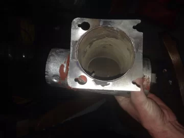

Does anyone know where I can get a new gasket for this? It came off when I was disconnecting the 4 bolt exhaust piece. I'd like to get a new one. It was a fibrous material
I would go to an automotive supply and see what sheet gasket material they have and cut your own.
From the stove manufacrurer or Woodsmans Parts (on here advertiser) or Northeast Pellet or in a pinch, use red RTV.
White lytherm gaskets are for burn pots and exhaust flanges or as stated above use red RTV
Fel-pro is a major manufacture of head and exhaust gaskets. Still putting off finishing the exhaust manifold on the Jeep:(
The exhaust of your stove should hopefully never go above 600. I don't know what gasket grade you have. If you can find the fire rating and its 600 or better your good to go IMO
