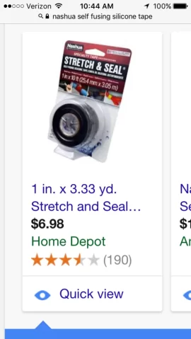

This is all I use. Easy to apply and easy to remove when needed. I do have black pipe so it blends in well and no need for paint with this stuff. Home Depot has it in plumbing aisle.

you do realize that stuff is highly flammable? This is why alum tape and stove specific RTV is always recommended
Don't know about your pipes but mine have never been near 500
with the stove going full I can still leave my hand on the pipe
mind you a full-tilt it gets very warm to the touch but only around 150 deg

I use JBweld RTV ultimate black for two of the seams in my 6" single wall pipe. This has a temp. rating up to 500F also.
I think my pipes can get up 300F during normal operation. But I guess worst case would be during a chimney fire though rare with pellet stove which would exceed 500F I am sure.
