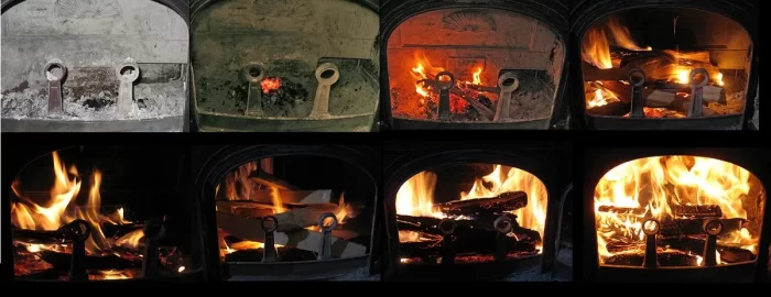

What does dry wood have to do with it? If anything, wet wood will burn with less smoke.... once you get it burning well. I can burn fresh cut trees almost smoke free all day long. Plenty of heat, too. In fact, I did that all day long yesterday, just to prove to myself I still know how. See any smoke in the box? Me, neither. No smoke from the chimney until I filled it with fresh cut wood, ran it up to 650º on the flue (926º on the face as measured with my IR gun) and shut the bypass damper. When I ran outside to take a video there was no smoke at first, then a thin veil started coming out. By the time I actually started to take the video, the smoke had cleared completely (less than two minutes) and the flue breathed nothing but pure, clear heat waves against a bright blue sky for several hours.
Wood was black birch that was cut down last Friday... bucked, split, and delivered on Saturday. Musta been at least 60% MC. Even the start up kindling was wet. No firestarter, just a tiny coal bed from the night before and the mighty BK lungs blowing it to life. Now, it did take a fair amount of time, and more TLC than I'd care to live with every day. Like I said, just wanted to make sure I still knew how to do it.
BTW yesterday's high temp was 15ºF, one of the coldest days of the winter. House went from 64º to 69º, and I kept it there all day burning sopping wet black birch in a "smoke dragon" in the basement. If I left any creosote in the flue, it must be "stealth" creosote, because I'm getting a lot more smoke with the same type of wood that is down to <10% water after sitting in the Battenkiln for 6 weeks.
