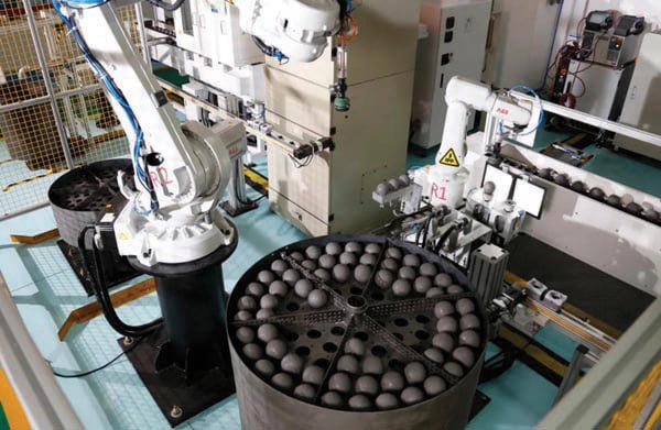

Interesting article on two currently operational SMRs
It was neat that the Chinese pebble bed did not need to shut down for refueling. Both seem to be operating with really reduced reliability.
