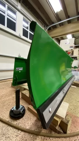

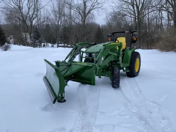

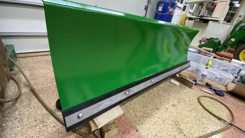

Snow will (hopefully) be here before we know it, and I wasn't real happy with my plow setup the last few years. With the skid shoes set 1/8" to 1/4" below the hardened steel edge, it manages to get the driveway pretty clean, but the steel edge really wrecks the top coat any place where the driveway has a bit of crown or contour... which seems to be a lot of places in my slightly hilly drive. I was also constantly worried about chipping my exposed agregate concrete walks, where they meet the driveway.
I switched to a 1" thick x 6" wide stiff rubber edged, clamped to the plow with a 1/4" x 3" piece of stainless steel, which was much friendlier to the asphalt. But it failed to get the driveway clean in our so-frequent ice or frozen rain storms. When it wasn't just skidding over what I wanted to scrape, it tended to push up between each of the half dozen carriage bolts that clamped it to the plow, leaving gaps between. Not ideal.
I'd like to find a stiffer plastic edge, but obviously something that won't just shatter when the plow catches a seam in the pavement. Any ideas/suggestions?
Here's the rubber edge I ran in 2021, removed out of frustration in the middle of last season.

UHMW PE is the only way to go. Lots of shops can cut UHMW sheet on a waterjet or router table.
It's a pretty common upgrade for snowblades.
We also use it extensively on the bottoms of shallow water jet boats to protect the aluminum hulls from scrapes on rocks.
I'm sure you have access to CAD to provide the cutting shop a .dxf file, should be easy.

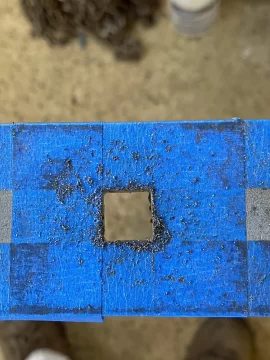

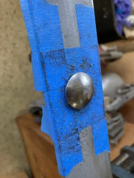

No issue, I should be able to just order a sheet of flat stock, and handle the machining myself. My plow edge is just held on with 6 carriage bolts, and capped with that stainless steel edge, which is narrower than the UHMW.
