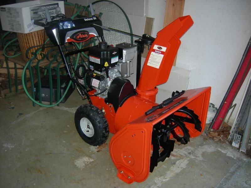

I have an amazing Ariens blower. It throws the snow amazing distances. But..
The reverse gears are sooooo slow!! ANd I mean SLOW! Is there any way to fix this?
Andrew
I don't think so, but I do agree with you. In fact, my latest Ariens which replaces one I had for years, is slower in top speed as well.
If it uses the disk drive system, you might be able to adjust the location of the friction disc to get more reverse speed, and AT the cost of top speed in forward.
Hrm. I will need to look into it further. A friend of mine said that it is possible to adjust the speed. I rarely use 6th speed other than moving the thing (we always get too much snow per storm..ha ha).

Do these machines have a friction drive or are they a transmission drive?
Check your friction wheel adjustment - as was mentioned above. Although, if it goes R1-N-F1 and back again OK with the blower moving the way it's supposed to, it's likely in adjustment. My friction disk I think has a little flat spot in one place that it gets bogged in once in a while in F1 - doesn't seem to do it in higher gears though. I'll be replcing for next year anyway.

It goes as it should. I just find the damn thing slow. If I fell over while it was in R2, I could cook a hot dog, eat it and get up before it ever came close to running me over. LOL
