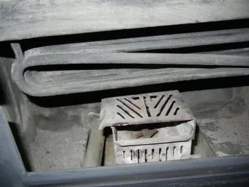

[Hearth.com] So, about these "Multifuel stoves?" [Hearth.com] So, about these "Multifuel stoves?" with and without the reflecting grate to get straight corn with its higher ignition temp to burn better

Ok, I see. Pretty big burn pot. How good does it work with pellets only, and on a low burn ? I like my 43, but a 45 would be cool for burning those junk pellets out there.
There is a separate pot for burning pellets and then don't need the end as the ash will just fall off the end. I burnt an average of 1.4 bags per day of some pretty ashy pellets that required ash pan dumping after 40 bags. But I also have the crosslink that the stove bumps the feed rate up a bit to keep the ESP happy. Also have the kit that has a different exhaust fan plate to up the stove btu rating to 50,000. I have the stove feed rate set to 3 and let it go. Set the ignitor to manual and let the slab soak up the heat for the long winter nights.
