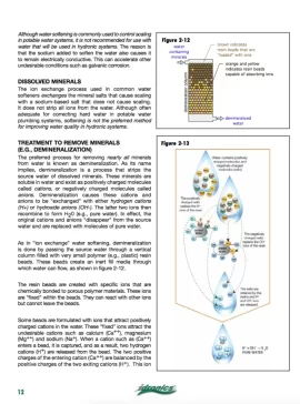

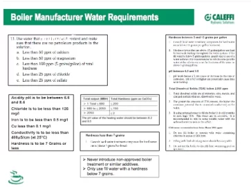

Here is some examples and comparisons, from Idronics.
  • [Hearth.com] Softened water

If you have aluminum and stainless components I highly recommend good fill water and conditioners. Most boiler warranty depends on water quality meeting the spec in the manual. Here are a few US boiler standard, I doubt tap water in many places meets many of these limits.
In Germany the have a VDI Standard that inspectors use when the check boiler installations. Bad water, no inspection sign off!
