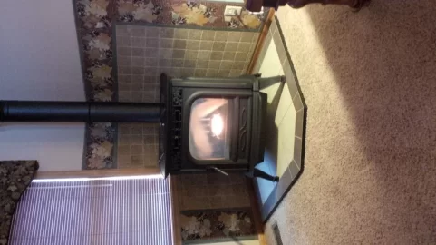

Here is a picture of the glass after one day of cleaning. Seems a lot of folks are having this problem. Wonder if Harman would address the issue or comment.

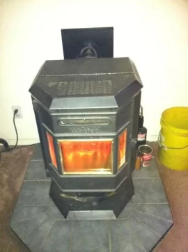

Here is a piccy of the little guy doing its thing after about a weeks burn time.
Today it will get a cleaning.
I gave up being anal about the glass many many years ago.
I know, I already said it but that was before I saw your pic. Now that I see your pic it does look EXACTLY like my glass(2 weeks old). Exactly the same. I would love to know the cause of this pattern but as long as it's not caused by a leak and/or messing with my stoves effeciency I can live with it no problem.
At least the whole glass does'nt get "smoked up" like my old(more efficient) 1990 Avalon does. Also, the quality of pellets has a major role in how smoky your glass gets. When I first got my old Avalon I picked up 10 bags(forget the brand) from Home Depot on the way home. I cleaned the glass every single day (really dark, thick buildup) and it took me at least 10-15minutes to get it clean(everyday) with a lot of elbow grease mixed with windex/ash formula. Once I switched pellets(to 100%DougFir) it only took me 20 seconds to wipe off the glass with a paper towell dampened with water.
All in all I love my new XXV-7
