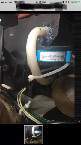

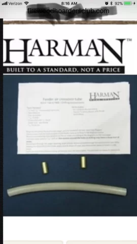

You can also install thecrosover air tube kit. Harman came out with this kit due to a strange acrid odor in some of their stoves. All new Harmans come with it.
I put one in my P38. See pics

Did installing the crossover kit eliminate the acrid odor?
Hello
Don 2222,
Yes on many stoves years ago.
Since the new stoves come with the kit installed it is no longer a problem.
Don2222,
Many thanks for this info. Installing the ash box door gasket got rid of the smoke problem, but then the acrid smell, which had been masked by the smoke, emerged. I try the kit.
Don2222,
The Kit says to use a 25/64 inch drill bit but I used a 3/8” inch drill bit and the brass collar fit much better. Also I used a small piece of wire to guide the collar into the hole from the back side. It worked great!
Good luck!
Good luck!
Don2222,
Thanks again for the tip about the drill bit. I work with wood (pianos), not metal. No problem drilling into a $30,000 Steinway grand, but a 9 year old $800 pellet stove gives me the willies. I'll drill a smaller hole, then work up to 3/8".
