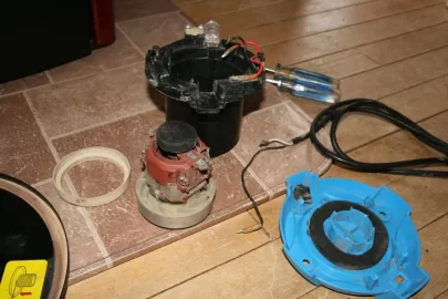

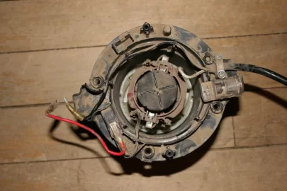

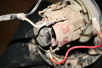

FWIW Pics of the motor.... Likely brushes are shot but I know nothing about electric motors:confused:
