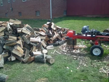

okay okay...... glad I didn't have to split this maple and cherry with my fiskars

Nice pile of wood.
Glad it was just a minor problem & not an engine failure. ;)
