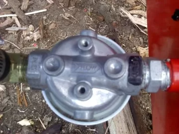

Using my splitter for 2nd time today. Used it for just a few minutes yesterday, when I got it, to make sure it worked. Now, I go out, start it up , and theres very little pressure. I know this sounds stupid- but could whoever have assembled the splitter installed the hydraulic oil filter backwards? Look at the pic. Shouldnt the flow arrow be pointing AWAY from the tank TOWARD the piston? This would cause the lack of power , would it not. I'm freakin out! I hope the machine isnt damaged. Help!

Wouldn't the tank be on the return side of the piston? I'd have to look at mine when I get home, but I think it goes from the tank to the pump to the valve to the piston to the filter and back to the tank.

I believe you are correct. The return line flows to the filter from there into the tank.

Filter is correct....fluid is filtered going back to the tank....check level and depending how cold it is where you are you should let it run for a bit before use to let the hyd oil warm up

the arrow is to indicate flow direction. If it is a suction strainer, the arrow goes from tank to pump, (but it wil be a strainer element, not a filter, and NEITHER are recommended.)
If it is a return filter, as most are, the arrow goes from control valve towards tank.
