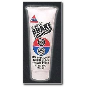

The graphite has worked well for me so I haven't bothered trying anything else. If I were to, I think I'd try something along the lines of this since I have it in the garage:
[Hearth.com] squeaky door
These are the lubricants used for brake jobs and can withstand up to 600 degree heat.
