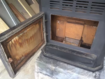

Are you going to shine it up and put in a new door gasket and igniter like this Pelpro I found?
Pic 1 - before
Pic 2 - after

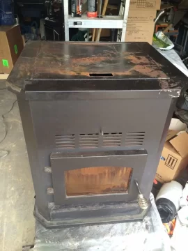

Do you have any pics of the stove?

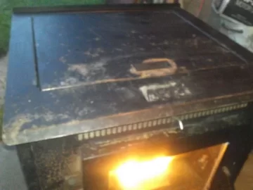

No tape, When the stove is running it will stay on low fire until I put a Jumper on the 2 pins then it go to what ever heat range you have selected, So it must be configured as big fire on call for heat and idle down and not shut off when the t stat is satisfied. Apparently any stat with points or even a light switch would control the stove. I suppose the jumper could be left on and simply choose a heat range and let it burn that way. She's on the rough side , It light up in less than 5 mins and burns really nice so we are happy. PIC
Fire looks good, if you have a chance this summer a cheap can of high temp stove paint works wonders!
See mine.
Click pic to enlarge.
  • [Hearth.com] SSSh   Theres a BIG Secret
Interesting, I sort of thought the Patina made the stove more valuable. I can see the For Sale Ad now..... Nice Original Unmolested condition.
