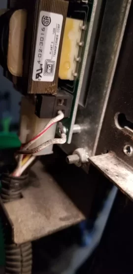

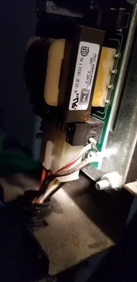

I have an old control board that does not have toggle that lets you choose which mode you are in. I have checked both of those and one of the wires inside the control board is loose and does not stay connected. does that need to be replaced? Is there a way to fix this without getting a new control board?? I push the wire in, but it does not feel like it grabs or stays connected. I will check it again now and get back to you. Thanks a lot.

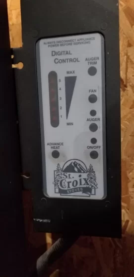

Here are some pics if that helps. That wire that I have exposed does not seem to want to stay connected. Any ideas on how to fix this??

Use a small jeweler's sized screwdriver to loosen screw on terminal block then insert wire and tighten screw so it stays in place.
Ok, that worked on the wire and I started it back up. It is burning good, but fan speed does not increase and the on/off button is still blinking. Any other ideas?? Everything works great, but something is keeping that light blinking.
Alright, I have turned it off, will unplug for a while and start it back up. Another thing I have noticed is that on/off button stays blinking even when I shut the stove off. I shut it off last night and this morning when I went out to start working on it, the on/off button was still blinking. Is that normal? do not remember that happening before. Only way to stop it is to unplug it.
Did you try putting a jumper wire across the black and red terminal block yet? It's the one on the back if the stove used for thermostats or manual mode with older control board versions.
Ok, put the jumper in and started it back up. BINGO, sucker is running good now. Thank you so much for your time and knowledge. I really appreciate it. One last question, If you could buy a 50000 btu or bigger multi fuel stove, what do you recommend? This auburn is 40000 btu and I thought it would keep my 25 x 30 garage warm. It has an open ceiling with two fans, the whole garage is insulated including the roof, but it still does not keep it above 60, even colder if the wind is blowing. Friends told me to just put a wood burner in and forget it, but I dont like dealing with wood, done it before and I like the pellets along with my corn that I have plenty of since I farm here in Iowa. thanks again.
